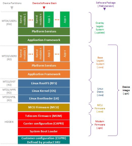

The Firmware and its components are mapped into the flash as follows:
Release 16.1/17 Components
WP8548 & WP75xx Firmware Release 16.1/17 combined image
