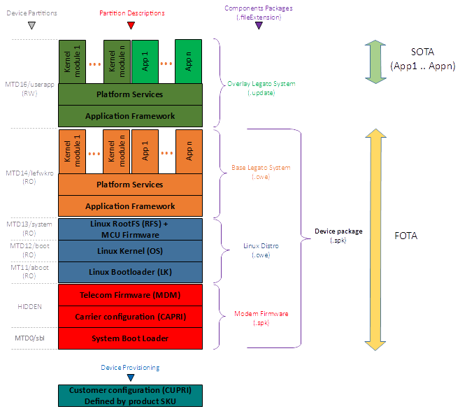

The Firmware and its components are mapped into the flash as follows:

Build your custom Device Image
Once you have customized one or several of the components from source, or once you have created your own Base Legato System, it is time to assembly the components in one Device Image.
Instructions for Linux CLI users
(Linux)
1. Install swicwe tool
2. To build your own combined image custom-firmware.spk from the following components:
    • Modem Firmware: modemFW.spk
    • Linux Distribution: boot-yocto.cwe
    • Base Legato System: legatoz.cwe
     you need to launch the following command line:
swicwe -o custom-firmware.spk -c modemFW.spk boot-yocto.cwe legatoz.cwe
Note 1:
You may decide to generate a custom Device Image without the full list of components (e.g. without Modem Firmware or without the Linux Distribution). If you do so, when you will flash this image later, only the components included within the custom Device Image package will be updated, the others will remain untouched. By doing this, you shall insure that the untouched components are compliant with the ones you are updating through the custom Device Image.
Note 2: If your custom Device Image is including a Base Legato System, when you will flash this image later, the Overlay Legato System will be erased and reinitialized with the same content as the Base Legato System.
