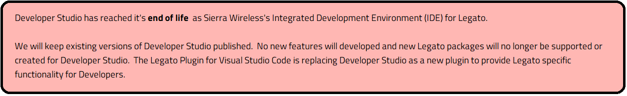

Check out our new IDE:
Legato Plug-in for Visual Studio Code
