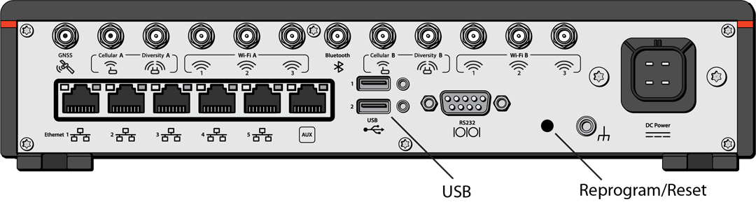

    1. Install the USB image on the MG90:
      1. Remove power from the MG90 (e.g. unplug the power cable).
      2. Insert the USB flash drive into either USB port in the center of the back panel.
      1. Press and hold the Reprogram/Reset button (you should feel or hear it click).
      2. While still pressing Reprogram/Reset, apply power to the MG90 (e.g. reconnect the power cable) and wait until the Power LED begins to blink green.
