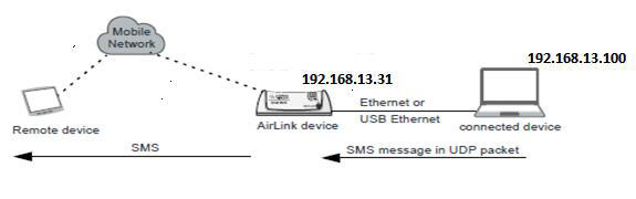

We will use the scenario shown in the figure below.

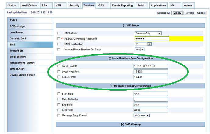

AirLink Device Setup
The screenshot below shows the configuration on the ACEmanager > Services > SMS screen. You can set the SMS mode as “Gateway or Control and Gateway”. Select “IP” in the SMS Destination field. In this example, the Local Host port and the ALEOS port have both been set to UDP Port 17431. You can use different UDP port values as long as the chosen ports are not in use by other applications or blocked by any firewall.
Refer to the ALEOS Software Configuration User Guide for a full explanation of the IP protocols used to send SMS messages. Based on the example in the ALEOS User Guide, the following example sends the message “THIS IS A TEST:” to the phone number 6046556677. This example uses the default delimiters matching the “Message format configuration”.

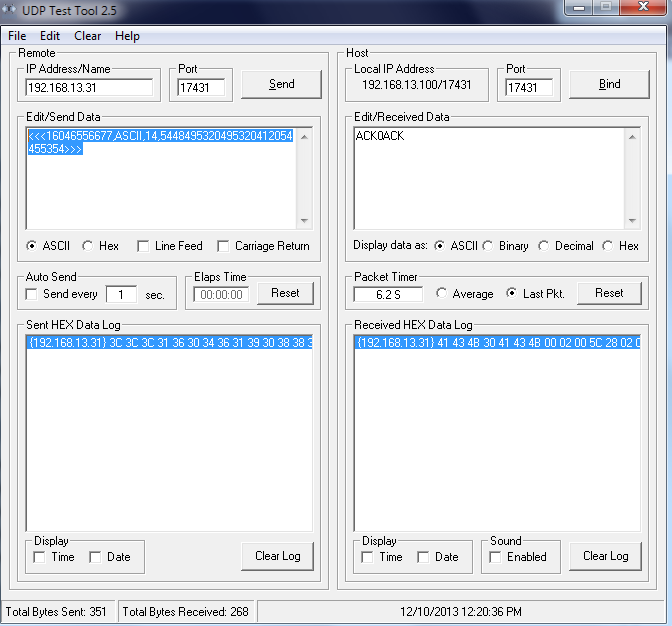

Host computer sending UDP packets
On the host computer, we have installed a program called UDP Test Tool (available for free from www.simplecomtools.com). For this example, we are using UDP Port 17431 on both the remote and host sides of the UDP Test Tool. The following screen shot shows the UDP Test Tool and command sent:
From the UDP Test Tool standpoint, the remote IP address is the AirLink device’s local IP — 192.168.13.31. The Local IP Address field is automatically set to whatever DHCP IP address the AirLink device has assigned to the computer. If the AirLink device is in its default configuration, then the Local IP Address that appears in the UDP Test Tool window is 192.168.13.100. We set the Remote and Host Port values to be 17431. The next step is to copy and paste the ASCII message referenced in the previous section into the Edit/Send Data box on the left side of the UDP test tool, and click the “Send” button.
The AirLink device should respond to the message sent from the UDP Test Tool with an “ACK0” message indicating that ALEOS has received the UDP message correctly and it will be sent out the AirLink device’s cellular interface as an SMS message. We have a list of other possible ALEOS Acknowledge messages at the end of this article.
