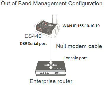

Setting up a Reverse SSH connection
The following illustration shows a standard out-of-Band (OOB) connection between the AirLink device and a router:

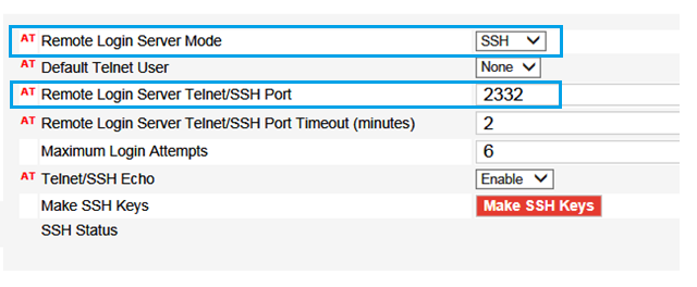

Enabling the SSH server
Navigate to ACEmanager > Services > Telnet/SSH and select SSH as the Remote Login Server mode.
It is important to enter the Remote Login Server Telnet/SSH port which is Port “2332” by default. This is the port that will be used when establishing SSH sessions.
Notes:
  • Since you have enabled the SSH server, you will be reaching the connected serial device by establishing a Reverse SSH session. Basically, Telnet has been disabled.
  • Keep in mind when opening SSH sessions that the port to be used is the Remote Login Server Telnet/SSH port.

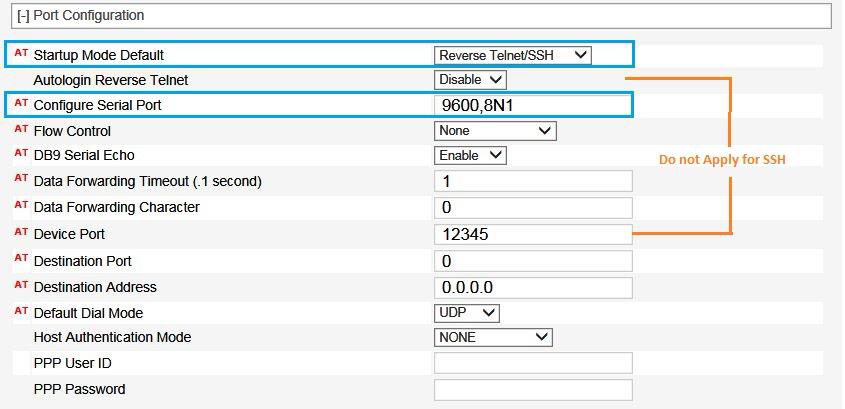

Enabling Reverse Telnet/SSH
Navigate to ACEmanager > Serial: Port Configuration and set Startup Mode Default to “Reverse Telnet/SSH”. Configure the serial port to match your serial device. Most routers console ports are set to 9600, 8N1.
Additional Notes:
  • The Auto login option is not supported when establishing Reverse SSH connections.
  • The Device Port is not used at all for Reverse SSH connections.

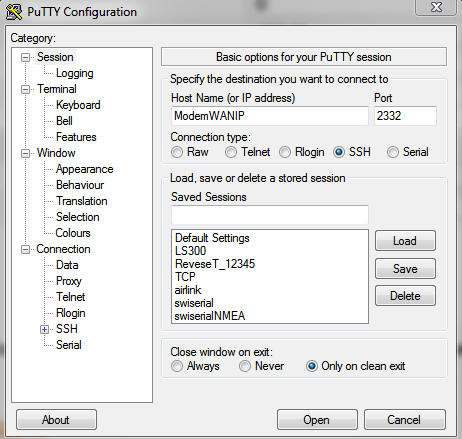

Testing SSH into a connected device

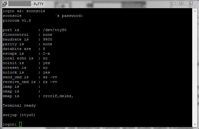

To test Reverse SSH functionality open any SSH application (e.g. “putty.exe”).
The following screen shot shows an example configuration from putty.exe. Replace Mode WANIP with the cellular IP address of the AirLink device from your Mobile Network Operator. For example: 166.10.10.10.
A message similar to the following is displayed:
If the correct cable is in use and the router is accepting OOB messages, a prompt will appear for the SSH login credentials. You must provide ALEOS Reverse Telnet/SSH credentials (username: sconsole, and password: 12345). Afterwords, a prompt for the router’s console login credentials username and password will appear.

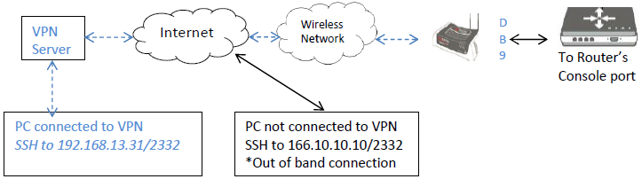

Reverse SSH and VPN
When the AirLink device is connected to a VPN, assuming it has the default device IP 192.168.13.31, you can access the OOB router on the serial console port from a computer on the VPN network establishing an SSH session to IP 192.168.13.31 on Port 2332. Please note that it is using the device LAN IP or Device IP address.
The connection is redirected to the device’s serial port, which in turn makes the connection to the router, as shown below:
*If the device has a VPN Split tunnel enabled, it means the ACEmanager out-of-band is set to "Allowed". It is possible to access the OOB router’s console port using the device’s Public WAN IP address, for example, SSH to 166.10.10.10 on Port 2332 by default.

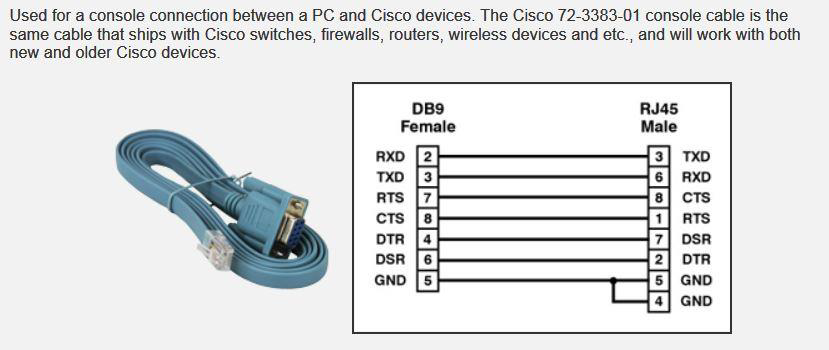

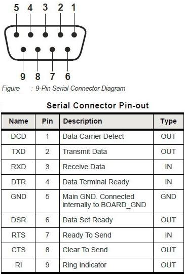

What is the DB9 pin-out for the AirLink device?

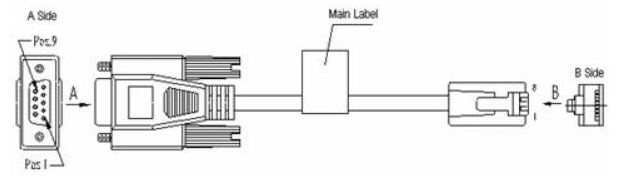

What are the DB9 and RJ45 standard pin-outs for Cisco cables?
This is described in the following diagram:
