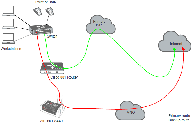

When the AirLink device is combined with a third-party router, the combined solution supports business continuity by providing primary and backup Internet access to one or more computers or other devices.
This guide provides instructions for configuring an AirLink device and a Cisco 881 router for WAN Failover. Figure 1 shows the network topology. This guide also applies to customers subscribed to the AirLink Enterprise Connect service.
Figure 1: Hardware Configuration for Enterprise Business Community.

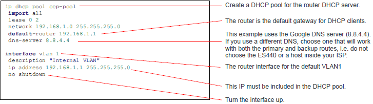

4. Configure the internal VLAN: 192.168.1.1 using DHCP.

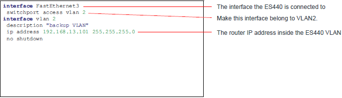

5. Configure the connection to the AirLink device as an independent VLAN.

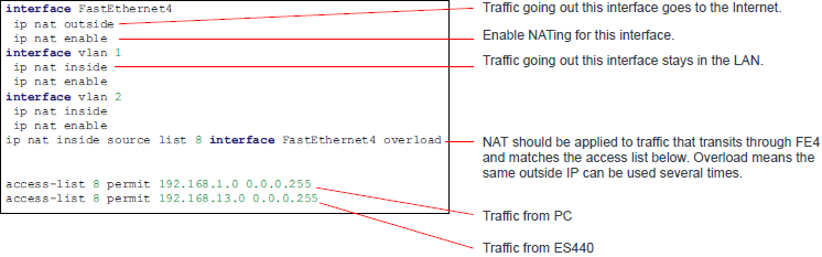

7. Configure the NAT rules to allow access to the Internet.
Note: If desired, you can add new criteria for the access list.

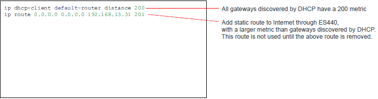

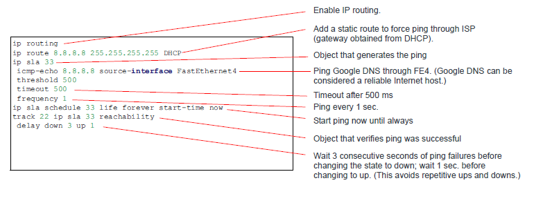

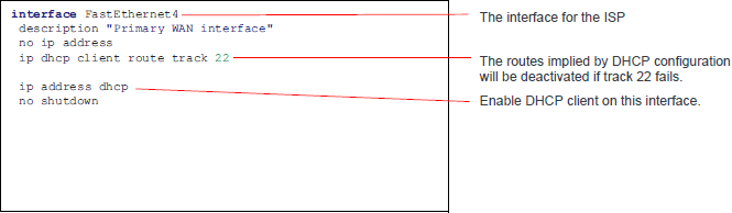

8. Configure the failover mechanism.
9. Configure failover routes.

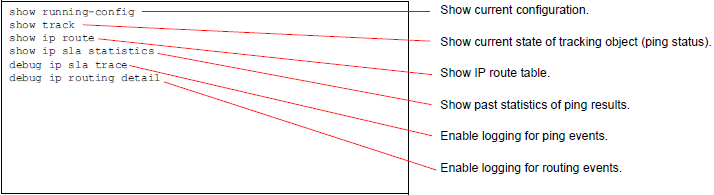

11. Key commands to monitor the router state.

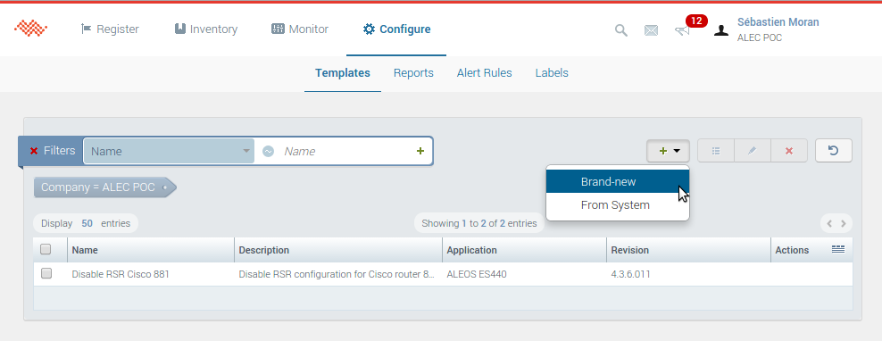

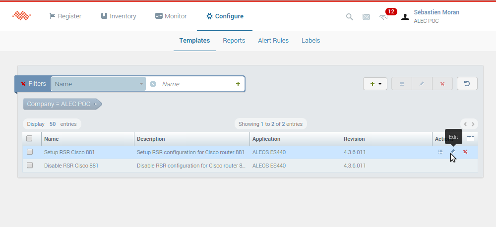

1. Log into your AVMS account and select Configure > Templates.
2. If you already have a template to Set up RSR on the AirLink device, select Actions > Edit and make any changes to the template that are required for your specific configuration.
3. If you do not already have a template, click the + sign drop-down menu and select Brand new.

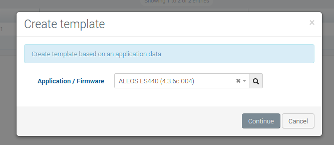

4. In the Application / Firmware window, select (or enter) the AirLink device (e.g. ALEOS ES440 (4.3.6c.004)):

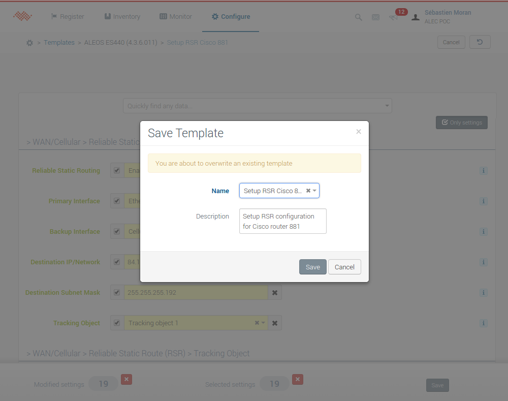

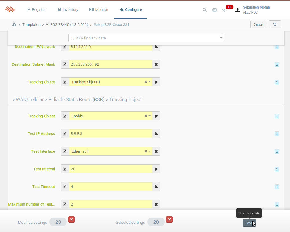

5. Enter the following sample parameters, or values for your particular configuration:
  -WAN/Cellular > Reliable Static Route (RSR) > Reliable Static Route (RSR)
      Primary Interface = Ethernet 1
      Gateway for Primary Interface = 192.168.13.101
      Backup Interface = Cellular
      Destination IP/Network = 84.14.252.0
      Destination Subnet Mask = 255.255.255.192
      Tracking Object = Tracking Object 1
   -WAN/Cellular > Reliable Static Route (RSR) > Tracking Object
      Test IP Address = 8.8.8.8
      Test Interface = Ethernet 1
      Test Interval (seconds) = 20
      Test Timeout (seconds) = 4
      Maximum number of Test Retries = 2
      Tracking Object = Enable
      Reliable Static Routing = Enable
   -LAN > Ethernet > General
      DHCP Server Mode = 0
   -LAN > Host Port Routing
      Primary Gateway = enable
      Host Network 2 = 192.168.1.0
      Host Network Subnet Mask 2 = 255.255.255.0
      Host Network 2 Route = Ethernet port
      Host Network 2 Gateway = 192.168.13.101
   -Optional (Helps when checking that your setup is correct)
      -Services > Telnet/SSH
         Remote Login Server Telnet/SSH Port Timeout (minutes) = 40
6. Click Save to create a new template or overwrite an existing one.

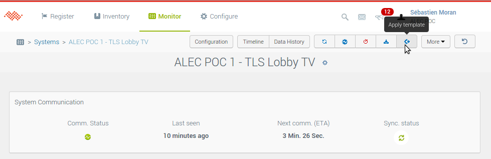

Apply the Template
1. Go to your system detail page and apply the template.
Note: Using an AVMS template is not mandatory. You can change settings directly on the System Configuration page. However, if you have multiple devices to configure, it’s a good idea to create an AVMS template.

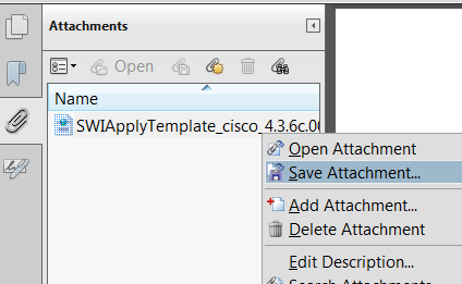

2. Save the template file attached to this PDF (SWIApplyTemplate_cisco_4.3.6c.004.xml).
   a. In Adobe Reader, click the Attachments icon on the left side of the screen. ().
   b. Right-click the template file, select Save Attachment, and save it as a .xml file.

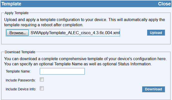

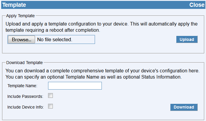

3. Launch your browser and go to http://192.168.13.31:9191 and enter the user name (default is user).

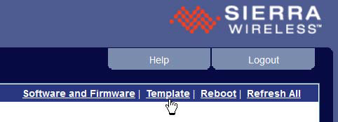

4. Click the Template button (at the right of the screen).
5. Click Browse....
6. Navigate to the template file saved in Step 2.
7. Click Upload.
8. Click Reboot.
