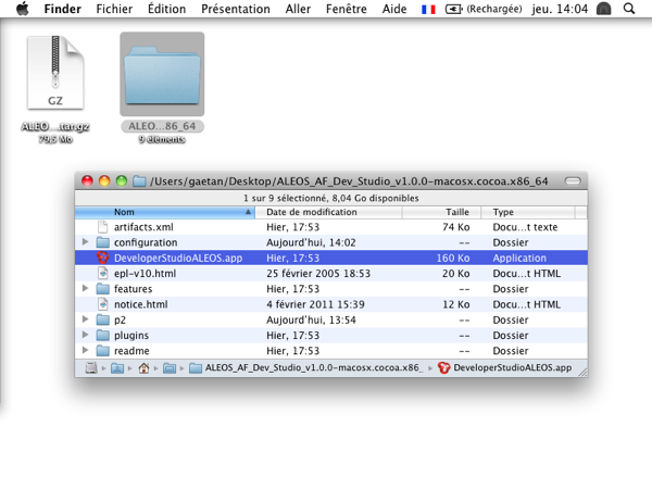

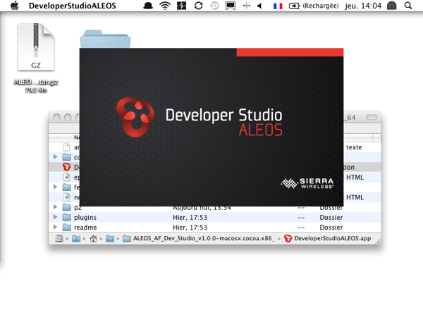

Step 01 The procedure for installing the Developer Studio is straightforward - once the archive file containing the product has been downloaded, it can be expanded anywhere on your file system.
Step 02 To start the Studio, run the executable file included in the expanded archive.

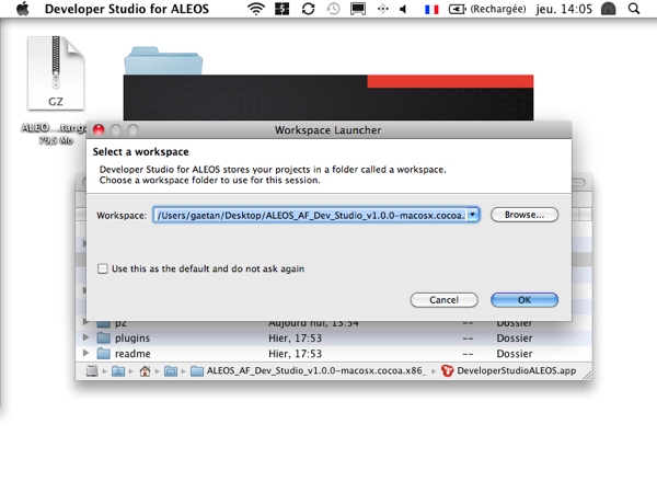

Step 03 By default, the IDE asks for a workspace location. Choose the default location (within the Studio's installation directory).

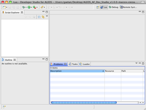

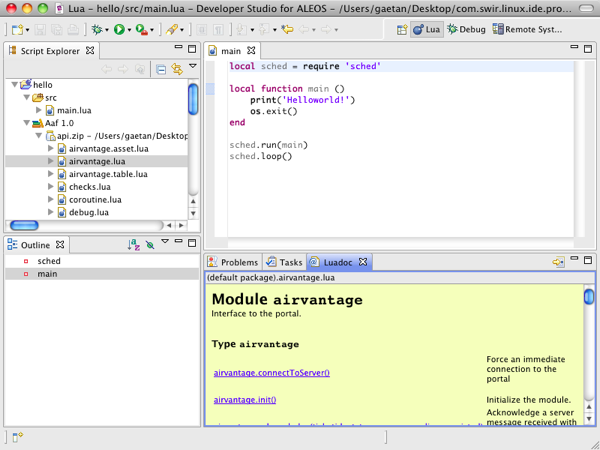

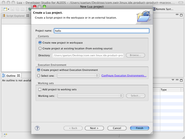

Creating a New Project

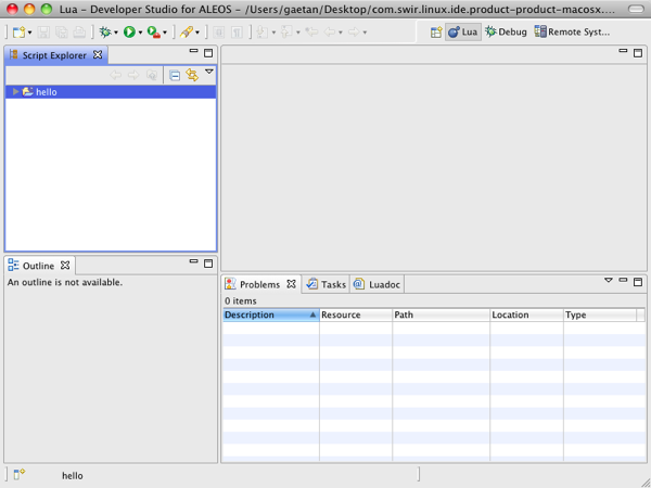

Upon execution, the Developer Studio opens on the Lua perspective. This perspective is dedicated to the management of scripting projects.

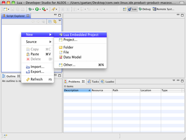

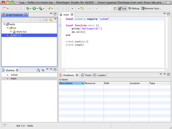

Step 01 To create a new project, right click in the Script Explorer view and select New > Lua Embedded Project. The New Embedded Project Wizard automatically opens.
Step 02 The wizard's first step (Lua Embedded Project) allows you to set the project name: for instance, to hello). Once set, click on [Finish].
Step 03 The new project now appears in the Script Explorer view:

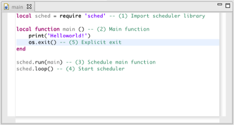

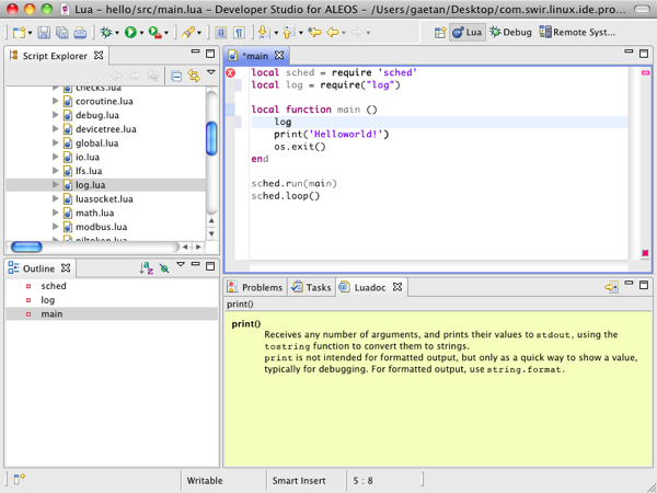

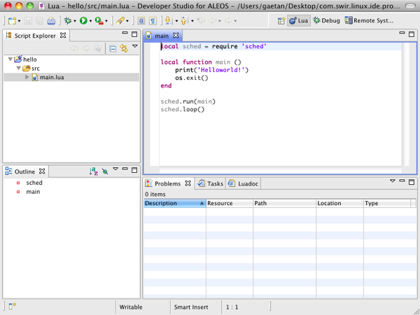

Editing the source code
Source files can be edited from the IDE's Editor area. Double click on the main.lua file. The Lua editor opens in the Editor area. The Outline view displays the structure of the source file.
Scheduler
The source file is the main entry point of the application for the ALEOS Application Framework. It is based on the scheduler system of the Framework. The scheduler library is first imported (1). A function is then created (2), representing one task of the application (here, print "Helloworld!" then stop the application). This function is added to the scheduler as a new task (3) (a kind of thread). The following step consists in starting the scheduler (4), which runs in an infinite loop until explicitly forced to quit (5).

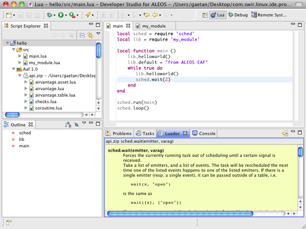

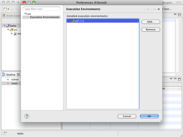

Working with an Execution Environment
An Execution Environment is an archive file containing the API and the documentation of the targeted framework (here AAF). The Developer Studio uses these package to provide users with specific support regarding the API.
The Execution Environment corresponding to the targeted version of AFF shall be downloaded in order to be used in the Developer Studio. It shall not be expanded.

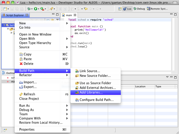

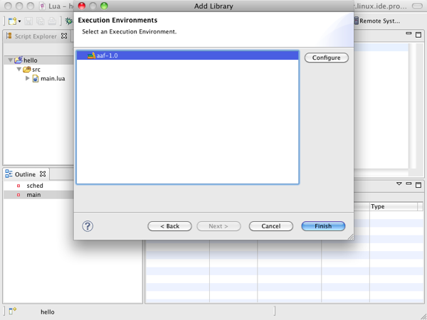

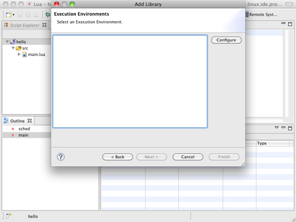

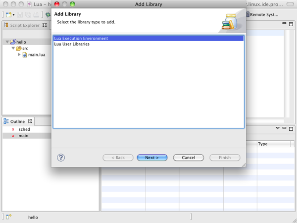

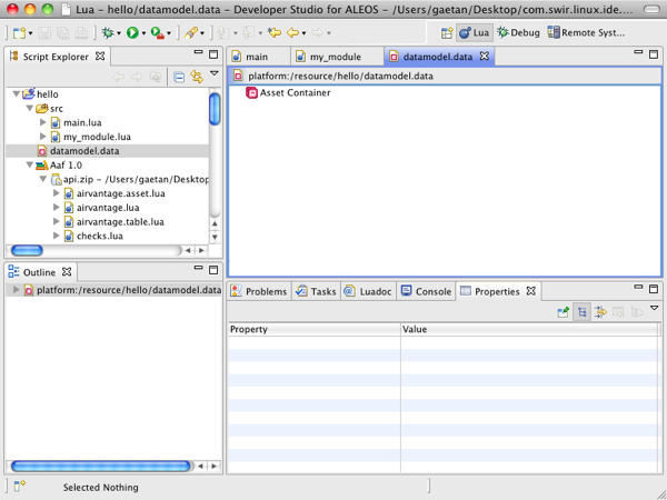

Step 01 Right click on the project and select Build Path > Add Libraries.
Step 02 Select Lua Execution Environment and click on [Next].

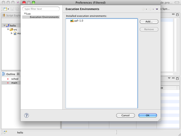

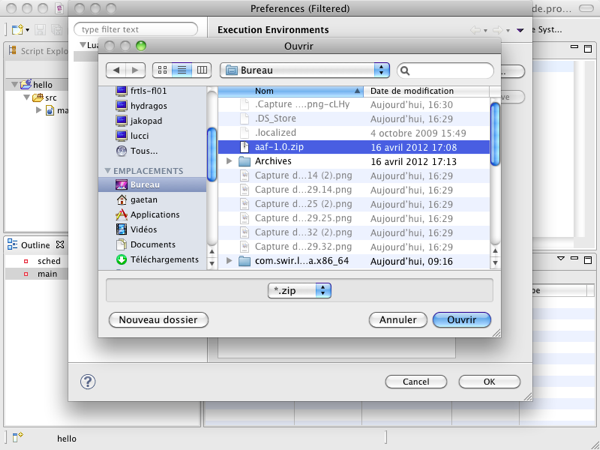

Step 03 Click on [Configure].

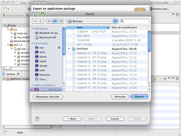

Step 04 Click on [Add] and browse the file system to select the execution environment archive file.
The Aleos Application Framework environment archive can be found under the sub-folder Developer Studio in the full package.
Step 05 Click on [Open].
Step 06 Select the Execution Environment for AAF.
Step 07 Click on [OK].
Step 08 Click on [Finish].
Step 09 The dependency to the execution environment has been added to the project. The execution environment can be unfolded and the various modules can be selected. The corresponding documentation is displayed in the Luadoc view.

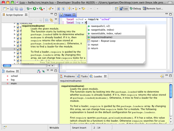

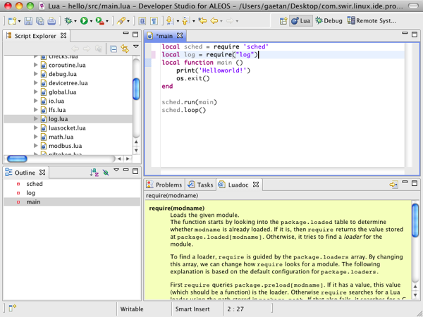

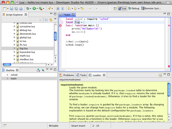

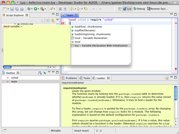

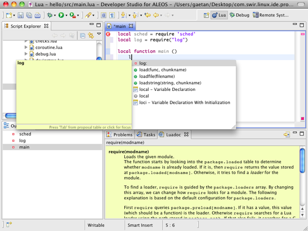

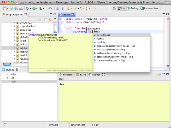

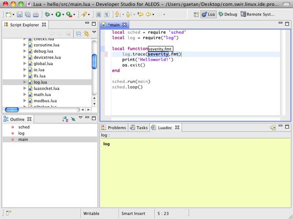

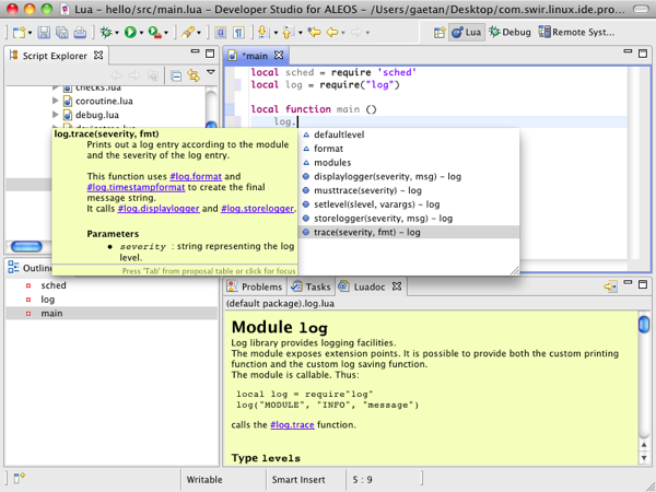

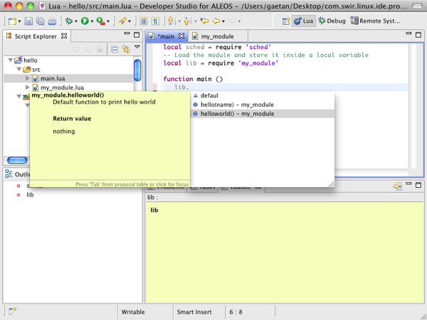

Leveraging Content Assist
Content Assist
The IDE can provide a tight support when typing code. By hitting control and space at the same time, it can suggest several possibilities to complete the line that is currently edited. These suggestion are context aware and may provide several type of assistance: code snippets (such as function, if structure, etc), global and local variables, object fields and methods.
Part of this assistance relies on the information provided by the Execution Environment explained in the previous section.
As an example of how content assist can be useful, we will make a simple use of the string library.
Step 1 Type "l" and hit control + espace. The IDE will suggest several possibilities.
Step 2 choose loci to create a local variable.
Step 3 The focus is automatically set on the name of the variable. Type "string" and press the tab key to switch the focus on the init value.

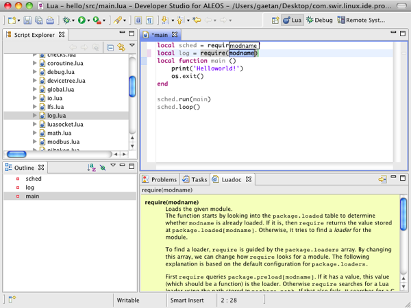

Step 4 Type "r" and hit control + space.
Step 5 Choose require to call the global function that imports modules.
Step 6 Type the string "string" and press tab.
Step 7 In the main function, type "s" and hit control + space.
Step 8 Choose the local variable string we just create.
Step 9 type "." to call a function of the string module, hit control + space the IDE will display all the fields and function of the string module.
Step 10 Choose the upper function.
Step 11 For the argument just type the string "UpperHelloWorld".

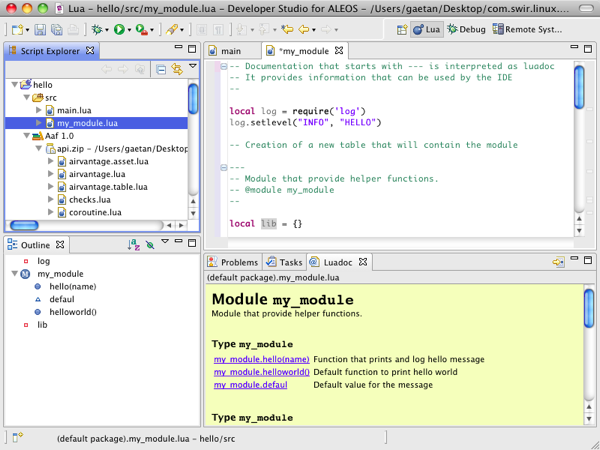

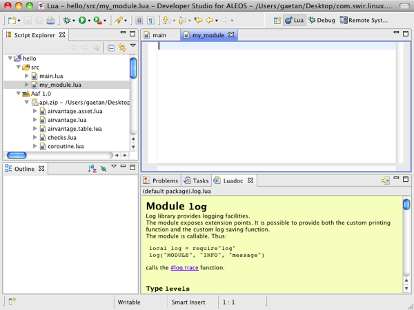

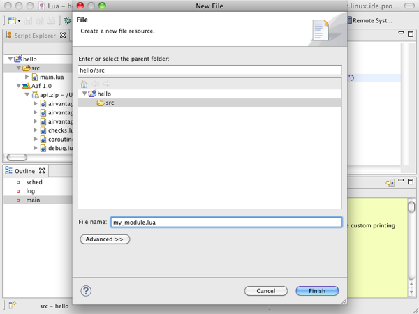

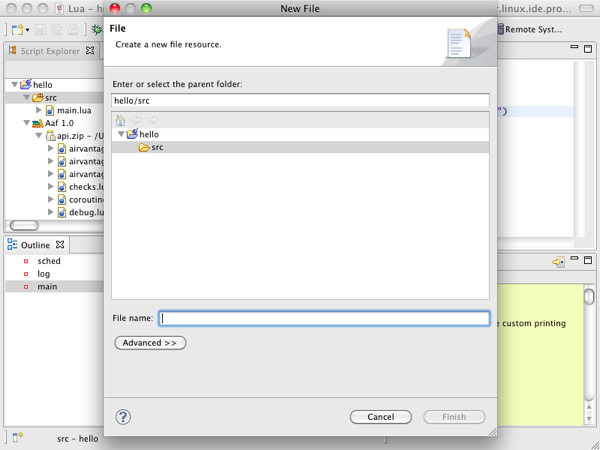

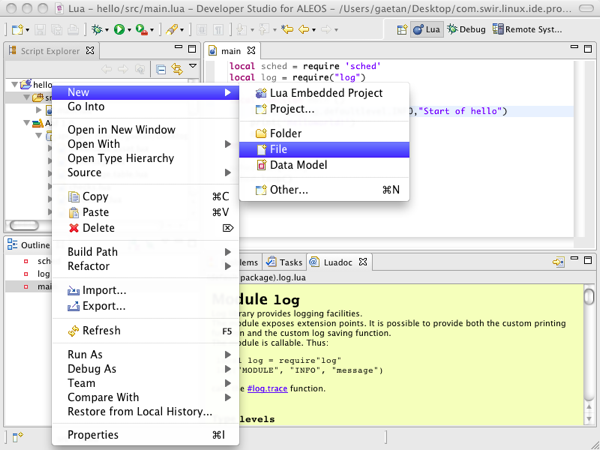

Adding a new file

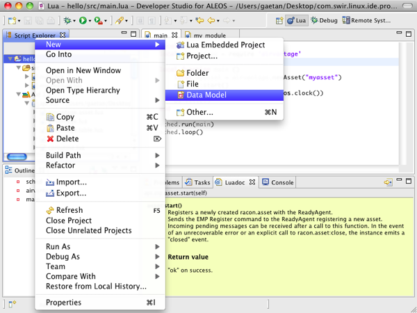

Step 01 In the Script Explorer view, right click on the src folder and select New > File. The New File wizard automatically opens.
Step 02 The wizard's first step allows you to enter a file name (my_module.lua). Once entered, click on [Finish]. The new file is added to the src project; it automatically opens in the Editor area.
Step 03 Copy-paste the following code in the editor opened on the newly created file and save it (Ctrl + S):

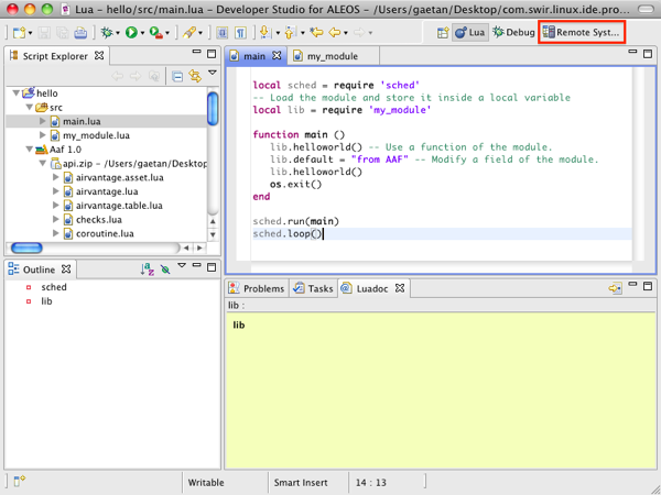

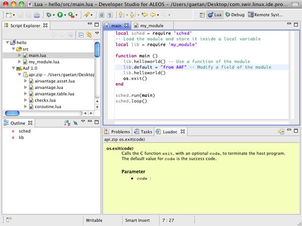

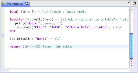

Module
In Lua, it is recommended to structure source code through the module construct. Modules are basically tables (table is the main data structure in Lua, and can be used as vectors, maps or sets). A module method is coded through a named field of the table that contains a function. Indeed, in Lua a function is a first class type, and functions can be stored in tables. Other kind of module attributes are simply fields containing data of different types: boolean, numbers, strings or tables (As Lua is dynamically typed, table can contain fields of different types).
To create a module, a local table must be initiated (1). Fields must then be added to it (2). The local table is eventually returned (3).
In short, a module is a source file that, when executed, returns a table containing functions and other data.

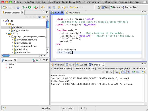

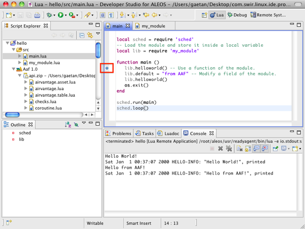

Step 04 Modify the main.lua so that it can use this module (local lib = require 'my_module'). You can use the content assist on lib to call the helper functions in your module.
local sched = require 'sched'
-- Load the module and store it inside a local variable
function main ()
   lib.helloworld() -- Use a function of the module.
   lib.default = "from AAF" -- Modify a field of the module.
   lib.helloworld()
   os.exit()
end
sched.run(main)
sched.loop()

Connecting to the device
There are two ways to connect a device to the PC in order to use it with the Developer Studio: USB and Ethernet.
Each ways enable to create a TCP/IP connection, with a default IP address for the device:
  • Over USB the IP address of the device is 192.168.14.31 and the one of the pc is 192.168.14.100.
  • Over Ethernet the IP address of the device is 192.168.13.31 and the one of the pc is 192.168.13.100.
    In the following documentation all the screenshot are done with an USB connection, the only difference with Ethernet are the IP addresses.
USB Driver
In order to use USB connection under Windows, the dedicated driver need to be installed. Refer to your device documentation to proceed to the installation.

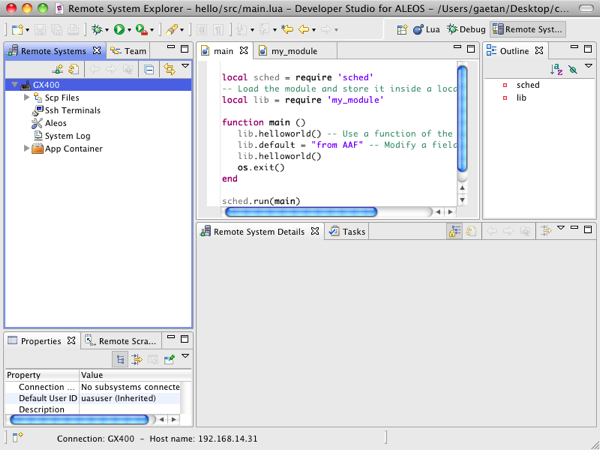

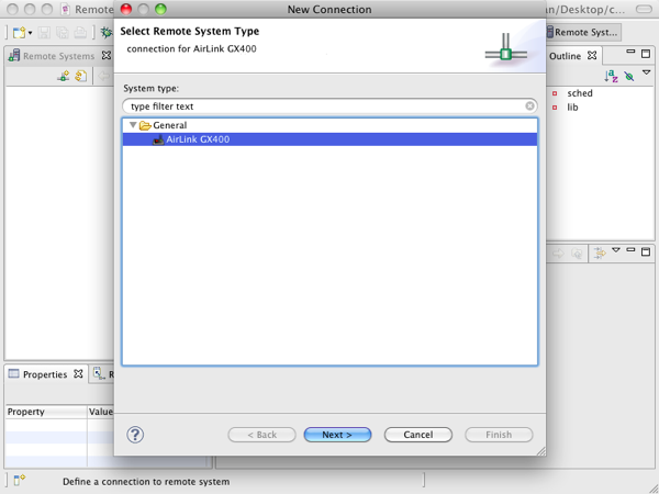

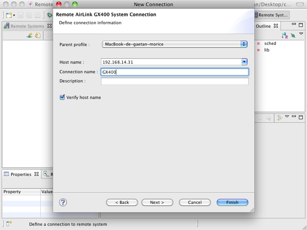

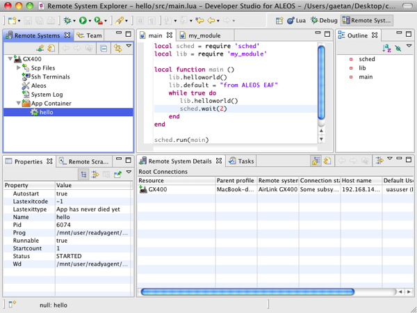

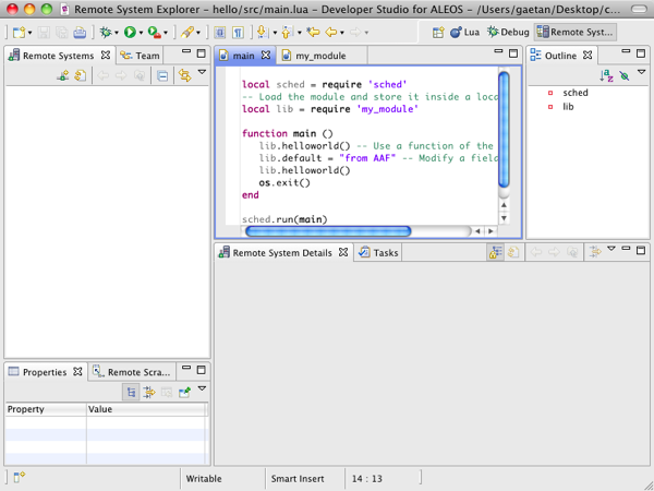

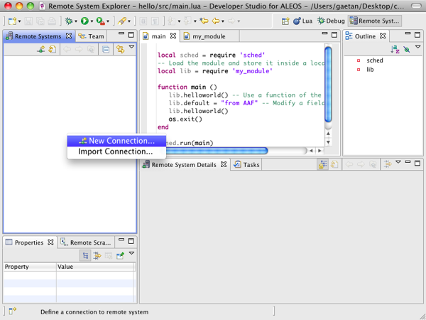

Step 01 Switch to the Remote System Explorer perspective by clicking on the icon in the toolbar.
Step 02 Create a new connection: right click in the Remote Systems view and select New Connection. A New Connection wizard automatically opens.
Step 03 The wizard's first step allows you to select the remote system type: select AirLink GX400 (General folder) and click on [Next].

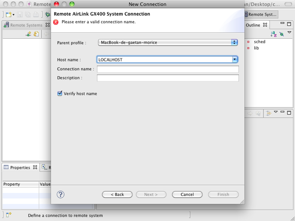

step 04 The wizard's second step allows you to set the host name: set it to the device IP address (by default 192.168.14.31 on USB and 192.168.13.31 on Ethernet).
step 05 Click on [Finish]. The new system appears in the Remote System view.

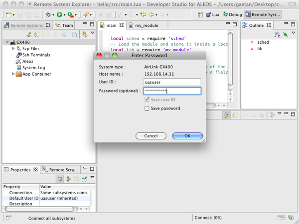

The connection to the device is done thanks to specific credentials. Please not that, these credentials are not the same as the one used for AceManager. Please refer to the ALEOS documentation to find the credentials of the used ALEOS version.
Up to 4.4.1 (included):
By default these credentials are uasuser : sierra12345.
Starting 4.4.2 and 4.5.0 (included):
Sierra Wireless gateways come without an AAF user password. Before using AAF, go to ACEManager, page Admin, Change Password to set up an AAF user password.
If you upgraded from 4.4.1 or earlier version, with a previous password saved in the Developer Studio, you may need to update the password saved in the Developer Studio:
  • Disconnect the Remote Systems connexion (if connected already)
  • right click on the Remote Systems connexion and select Clear password
  • Connect again, enter new password, check Save password if you want to.

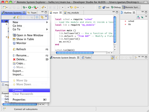

Step 06 Right click on the system icon in the Remote Systems view and select Connect.
Step 07 A modal window opens asking for a user id and password.
Step 08 Click on [OK]. You are now connected to the device (successful connection is indicated by a green arrow in the system icon).

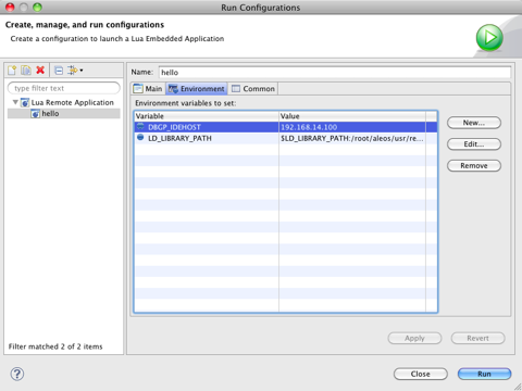

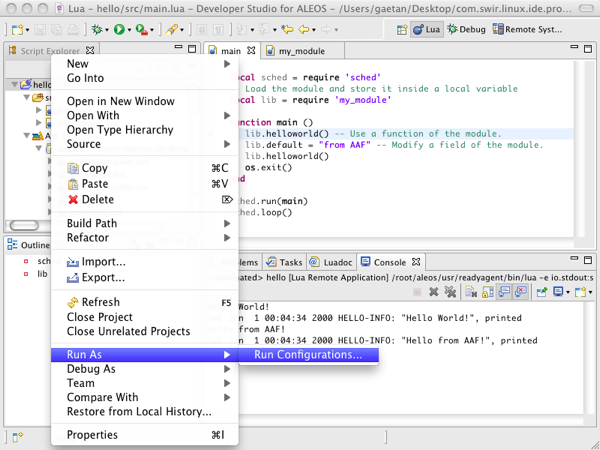

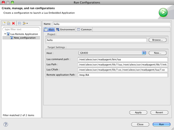

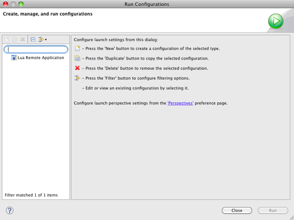

Launching the application

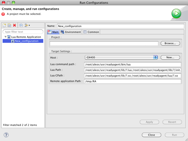

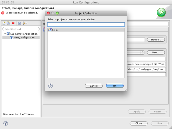

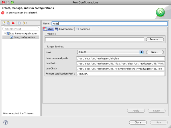

Step 01 Switch back to the Lua Embedded perspective. Right-click on the project and select Run As > Debug Configurations .... A Run Configurations modal window automatically opens.
Step 02 Right click on the Lua Remote Application launch type and select New action.
Step 03 Enter a name in the Name field (for instance hello).
Step 04 Select the project by browsing in the Project section and select the connected device in the Host drop-down menu.
Step 05 Click on [Run]. The application is uploaded into the connected device and executed through a shell. The standard output (and input) is redirected into a console within the IDE.

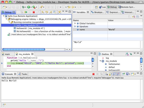

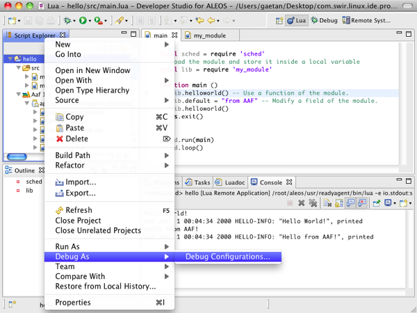

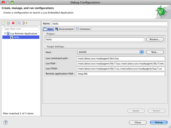

Debugging the application
Setup
In the debug protocol used by the IDE, the application is the client. It needs to connect to the IDE, thus requiring some setup:
  • You have to setup the server IP (i.e. your PC IP on the device network, 192.168.14.100 by default on USB and 192.168.13.100 on Ethernet). The IP can be edited in the previously described Run Configurations modal window: Environment tab, (DBGP_IDEHOST variable).
  • If you have an active firewall on the device network, you either need to authorize external access on the port (10000ish: 10001, 10002, ...) or to deactivate the firewall for the corresponding interface (for instance usb or eth0).

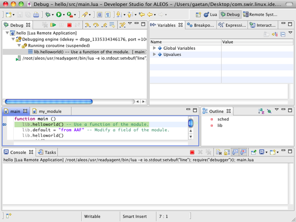

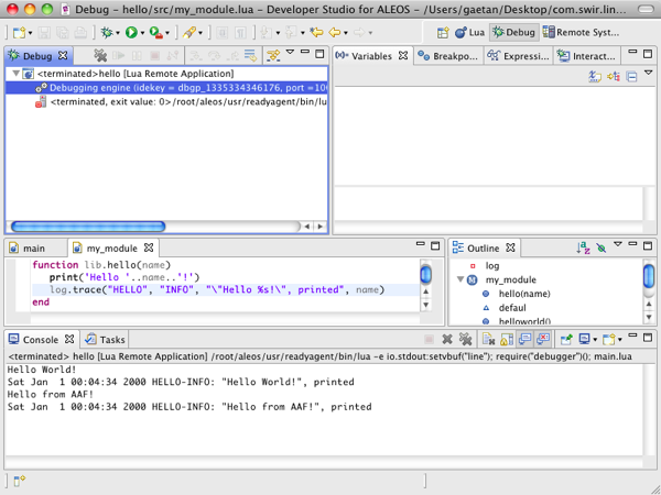

Step 01 You have to setup a break point in the code in order to stop the debugger. To do so, double click in the left margin of the line where you want the debugger to stop.
Step 02 Launch the application in debug mode: to do so, right-click on the project and select Debug As > Debug Configurations. A Run Configurations modal window automatically opens.
Step 03 Select the launch configuration previously created to run the application and click on [Debug]. The application is downloaded on the device and started in debug mode.

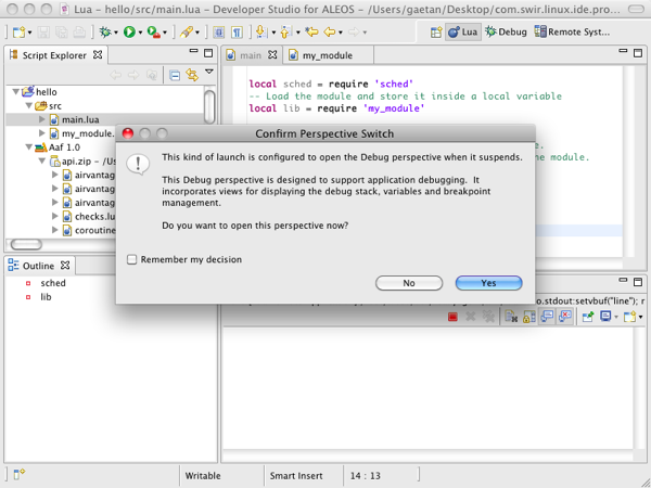

Step 04 The IDE asks you if you want to switch to the debug perspective - accept by clicking on [Yes].
Step 05 Use the debug perspective to execute your application step by step and step into the called functions.
Step 05 Resume the execution of the application. It will automatically finish.

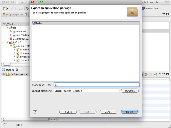

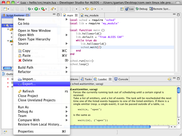

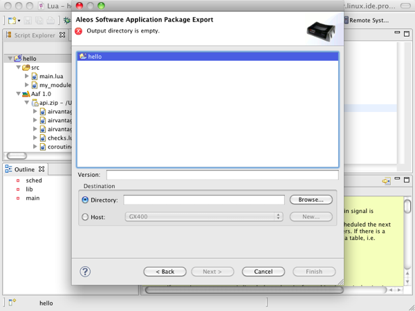

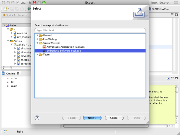

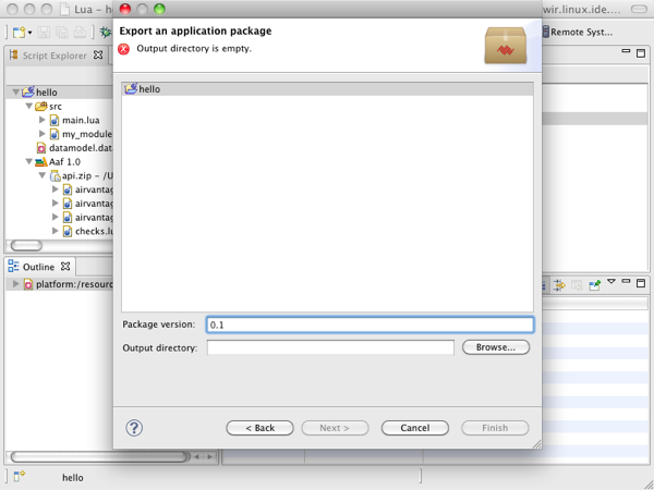

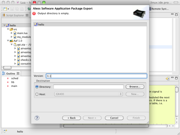

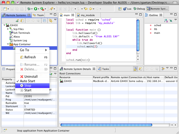

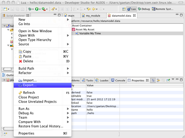

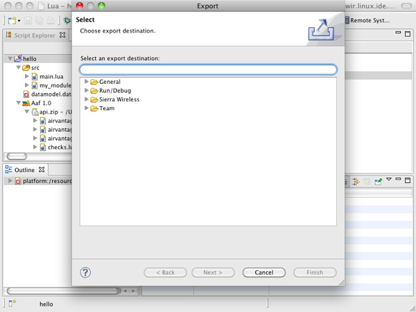

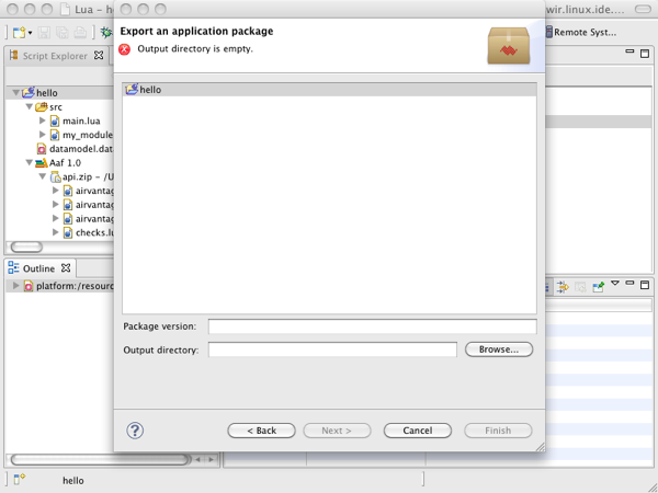

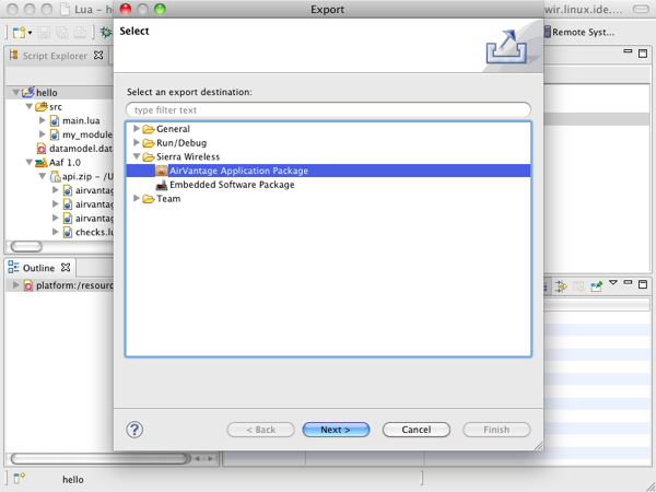

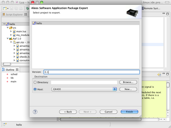

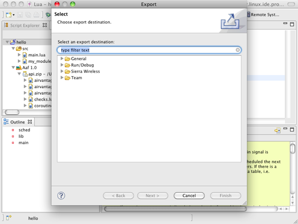

Step 02 Right click on the project and select Export... to open the Export Wizard.
Step 03 Select Sierra Wireless > Local Application Package. Click on [Next] to open the installation wizard.
Step 04 Enter the version of the application, for instance 0.1. Select Host destination and the device on witch you want to perform the installation.
Step 05 Click on [Finish]. The application will be downloaded to the device and installed into the Application Container. Switch to the Remote System Perspective and in the Remote System view unfold the App Container service to see the running application (decorated with a green arrow).
Step 06 Right-click on the application to have access to a set of commands about the life-cycle of the application:
  • Uninstall the application.
  • Configure the Autostart (whether the application is started at boot time) property.
  • Stop or Start the application

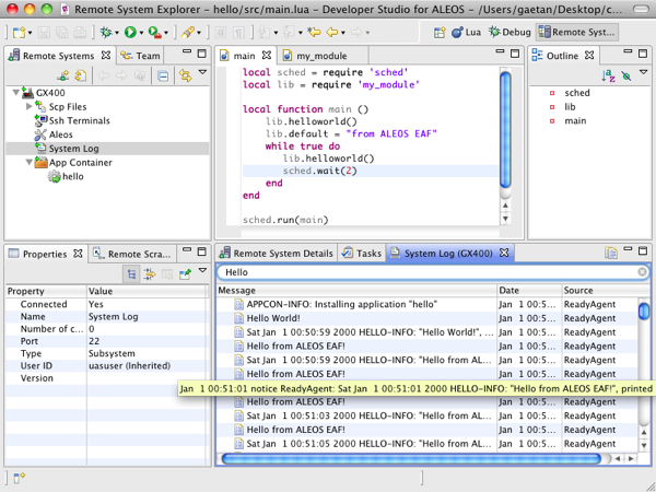

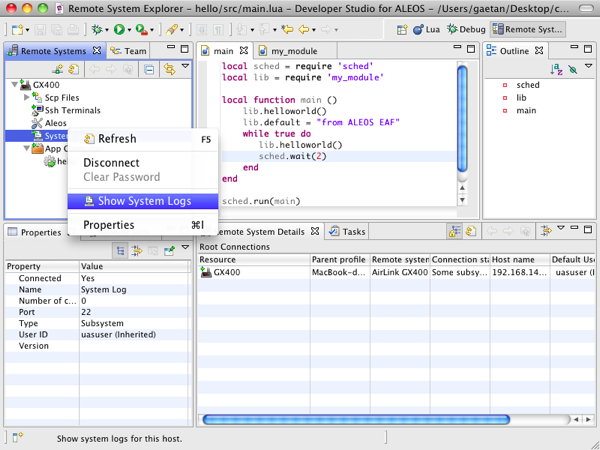

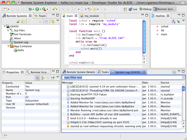

Step 07 Right-click on the System log service and select Show System Logs to open the System Log view that show all the logs
Step 08 In the filter field of this view, enter "HELLO". All entries logged by the running application and including this character string are displayed in the view.

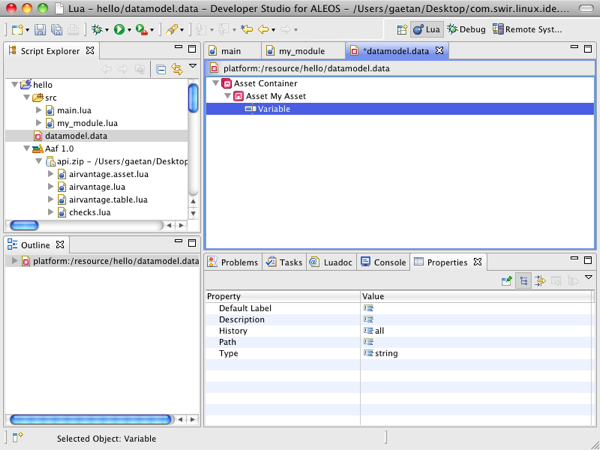

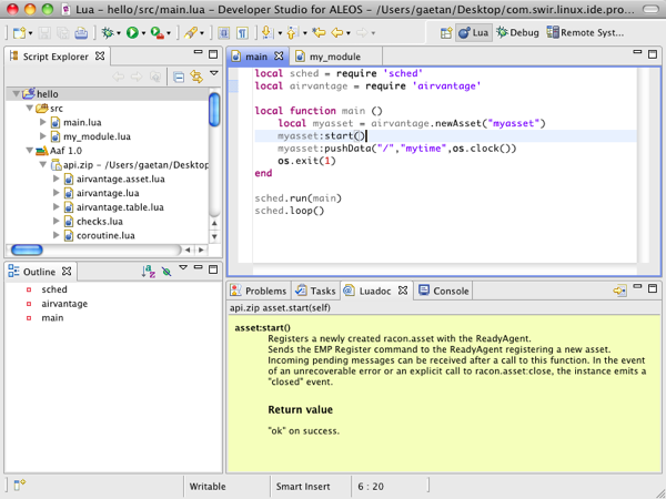

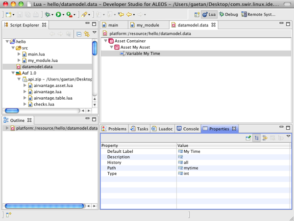

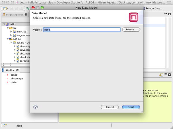

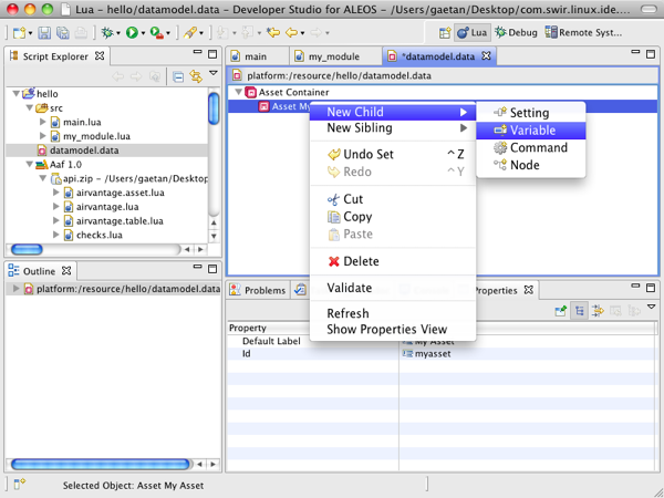

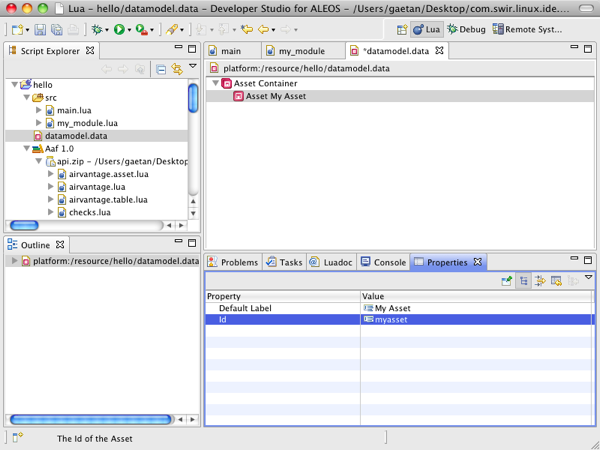

Leveraging AirVantage

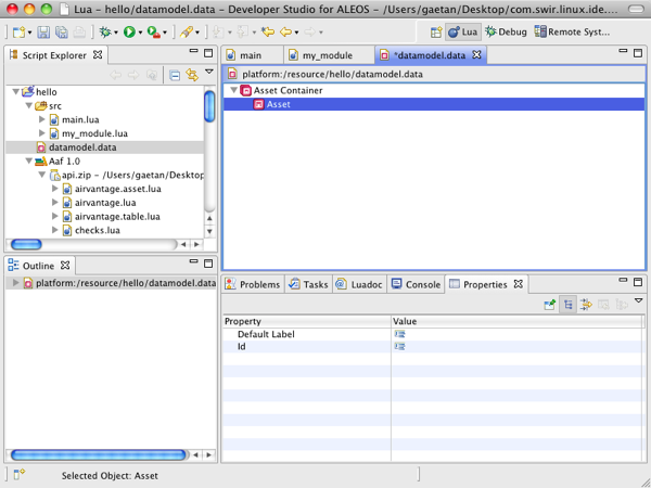

AirVantage Application Service
Step 01 Modify the main function of the application in the main.lua file so that the application use the airvantage library to send data (replace the content of the file with the following code) :
local airvantage = require 'airvantage'
local function main ()
	local myasset = airvantage.newAsset("myasset")
	myasset:start()
	myasset:pushData("/","mytime",os.clock())

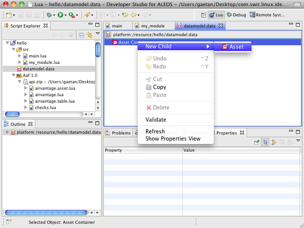

Step 02 Right click on the project and select New > Data Model to open the New Data Model Wizard.
Step 03 Select the hello project and click on [Finish]. It will add a datamodel.data file to the project, open it in the dedicated editor and open a Properties view.
Step 04 To describe the asset created in the main.lua file, right-click on the Asset Container and select New Child > Asset.
Step 05 Select the new Asset node in the model and edit the elated properties in the Properties view:
  • Default Label: My Asset
  • Id: myasset
Step 06 To add a variable to this asset, right-click on the Asset node and select New Child > Variable.
Step 07 Select the new Variable node in the model and edit the elated properties in the Properties view:
  • Default Label: My Time
  • Path: mytime
  • Type: int
Step 07 To open the export wizard, select the hello project, right-click and select Export....
Step 08 Select Sierra Wireless > AirVantage Application Package. Click on [Next] to open the export application wizard.
Step 09 Enter the version of the application, for instance 0.1 and select the output directory by clicking on [Browse].
Step 10 To perform the creation of the package click on [Finish].
