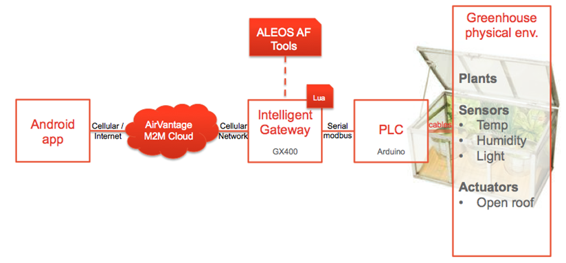

Greenhouse M2M application
If you passed by Sierra Wireless booth at Embedded World Congress this year, you may have seen & played with this nice greenhouse M2M application using an Arduino, an AirLink GX400 gateway, the AirVantage M2M Cloud, and an Android application on a tablet, to remotely monitor the temperature, light and humidity, and control the greenhouse roof.
This end-to-end M2M application is composed of a mini greenhouse with 3 sensors: temperature, light and humidity, plus a motor to open/close the roof of the greenhouse, connected to an Arduino Uno.
The Arduino is used to simulate an industrial PLC talking modbus. It simply keeps updating a modbus register with sensors values, and returns the modbus register when someone asks for it.
The "intelligence" of the application resides in the Lua code running on a Linux gateway (here a ruggedized AirLink GX400, although the code provided below works on a simple Raspberry Pi as well). The application is developed using the ALEOS AF development tools which are based on the open source project Koneki. The Lua application uses the open source framework Mihini to query the arduino via modbus, compute the raw data (change integers values into physical entities, and detect changes), and update the server (AirVantage M2M Cloud) whenever a value has changed.
On the server side, we used the Corona (Lua as well) framework to develop and generate an Android/iOS application for smart phones & tablets, that query the AirVantage M2M Cloud API (REST/Jason) to get sensors values.
On a click action on the switch on the iOS/Android application, the mobile device sends a command to the remote gateway thru the M2M Cloud. On reception of this command, the Mihini/ALEOS AF application updates the modbus register to let the arduino know that the roof has to be opened/closed*.
*Note: unfortunately, this part is not demonstrated in the video because we broke the motor the day before registering the video.
